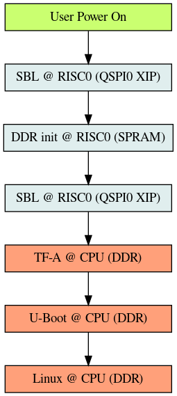

Загрузка в режиме QSPI0 XIP
Последовательность загрузки приведена на диаграмме. В скобках указан источник исполнения.
digraph G {
  node [ shape = box, style = filled, width=2.5, height=0.4]
  poweron [label = "User Power On", fillcolor=darkolivegreen1]
  sbl1 [label = "SBL-XIP @ RISC0 (QSPI0 XIP)", fillcolor=azure2]
  ddrinit [label = "DDR init @ RISC0 (SPRAM)", fillcolor=azure2]
  sbl2 [label = "SBL-XIP @ RISC0 (QSPI0 XIP)", fillcolor=azure2]
  tfa [label = "TF-A @ CPU (DDR)", fillcolor=lightsalmon]
  uboot [label = "U-Boot @ CPU (DDR)", fillcolor=lightsalmon]
  linux [label = "Linux @ CPU (DDR)", fillcolor=lightsalmon]
  poweron -> sbl1 -> ddrinit -> sbl2 -> tfa -> uboot -> linux
Рис. 2 Последовательность загрузки в режиме QSPI0 XIP

SBL-XIP: Build: 24cdac606c8e45e08368d8205d7c672e
U-Boot 2024.07 (Apr 06 2025 - 02:38:26 +0000), Build: 24cdac606c8e45e08368d8205d7c672e
[    0.000000] Linux version 5.10.179 (zuulbot@049204495b62) (...Buildroot v1.0-1158-ga40d968-24cdac606c8e45e08368d8205d7c672e) ...
# cat /etc/os-release
NAME=Buildroot
VERSION=v1.0-1158-ga40d968-24cdac606c8e45e08368d8205d7c672e
ID=buildroot
VERSION_ID=1.0.0
PRETTY_NAME="Buildroot 1.0.0"
# cat /proc/device-tree/chosen/u-boot,version
